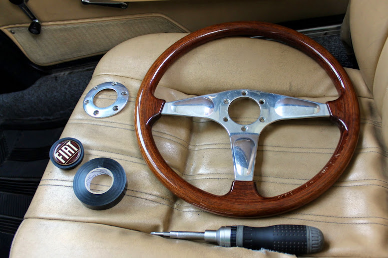

Determined to get this beautiful new (to me) steering wheel on with a functioning horn I sat down and got at it
First got all my stuff

Still had the horn getting stuck when pressed Took it out and lightly sanded the plastic and then it fit smooth and allowed the horn to depress and rise with zero issues
After reading this,I remembered that I had the same issue,when installing my MOMO wooden wheel.I did exactly the same thing.Worked it with a little sandpaper,and all is well.Your wheel looks fantastic!!
